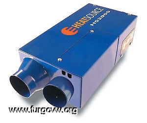

Aquí uno que va a propano o butano....
https://www.ebay.es/itm/Propex-2000-Heater-Gas-Vehicle-Thermostat-rave-van-work-shop-log-cabin-pod-heat/142553227124?_trkparms=aid%3D777003%26algo%3DDISCL.MBE%26ao%3D1%26asc%3D20140620091512%26meid%3D2b2a900d36684e17a80dd1ac829a4897%26pid%3D100009%26rk%3D4%26rkt%3D5%26sd%3D201955247515&_trksid=p2047675.c100009.m1982
https://www.youtube.com/watch?v=vVP9_uQB9xE
https://www.youtube.com/watch?v=8x5sML6q-RY
