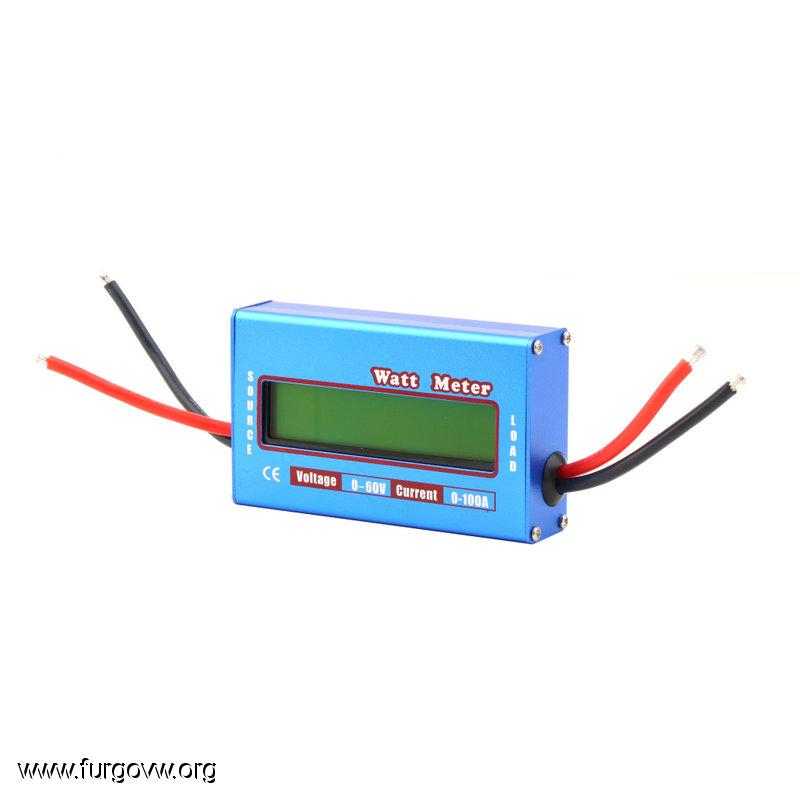

Para los que tengan un regulador sin pantalla informativa o para cotillear consumos y tal. Solucion por 7,25€
http://www.ebay.es/itm/Boat-RC-Helicopter-Watt-Meter-DC-60V-100A-Balance-Voltage-Battery-Power-Analyzer-/161897782880?hash=item25b1dc1e60:g:JqcAAOSwcBhWVRCp
Citar
Examples of Uses:
How Much Power Does my Fridge Use - with the Battery connected to the SOURCE side and Car Fridge (or other accessory) connected to the LOAD side. The Watt Meter shows the current into the Fridge, voltage and power at the battery and accumulates the Ah and Wh while the fridge is running.
How much charge is going into my battery - With a battery charger (or alternator) connected to the SOURCE side and the aux battery connected to the LOAD side, the Watt Meter shows the charging current into the battery, the voltage and charging power at the battery and accumulates the charge (Ah) and energy (Wh) into the battery.
What is the output of my solar panel  - With a solar panel connected to the SOURCE side and solar regulator connected to the LOAD side, the Watt Meter shows the charging current into the regulator, the voltage and charging power at the solar panel and accumulates the charge (Ah) and energy (Wh) into the regulator.
How much charge is my solar panel putting into my battery - Now with a solar regulator connected to the SOURCE side and battery connected to the LOAD side, the Watt Meter shows the charging current into the battery, the voltage and charging power at the regulator and accumulates the charge (Ah) and energy (Wh) into the battery.
Manual (en ingles) del modelo de 150A, pero es idéntico.
http://img.banggood.com/file/products/20151014023937SKU270713.pdf
P.D perdón por no traducirlo pero estoy cansado y me voy al sobre  ;)

Cita de: perroflautero en Febrero 18, 2016, 02:06:32 am
y por essos cablecillos pueden passar 100Ah.???  creo k no!
o es que va con alguna derivacion tipo Shunt?
Hoy aqui , mañana alla... y passado quien sabe!!!

los medidores de corriente suelen llevar shunt. Este a lo mejor lo lleva dentro o si no vendrá a parte y por eso no sale en la foto...
