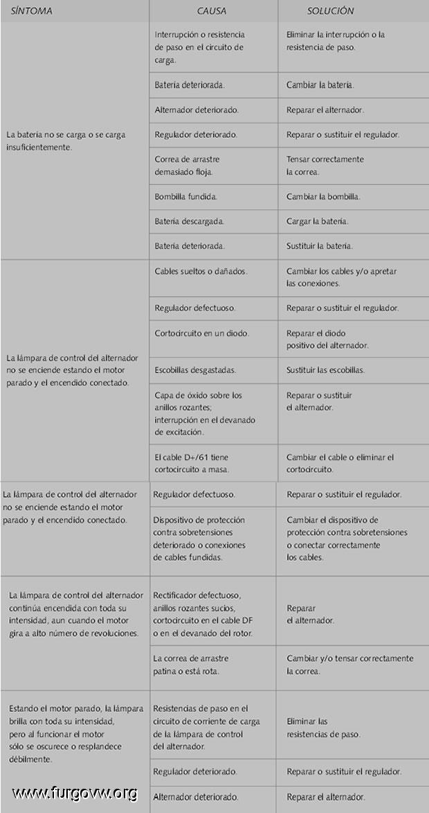

Hi godfather, I think is better if you write in english, and we will try to translate...
Before uninstall the alternator belt, please check the status of regulator, it is fixed in alternator
Unmouth the regulator and check the status of brushes
If it has worn, replace for new one
Please, let us know the result,
Good luck
