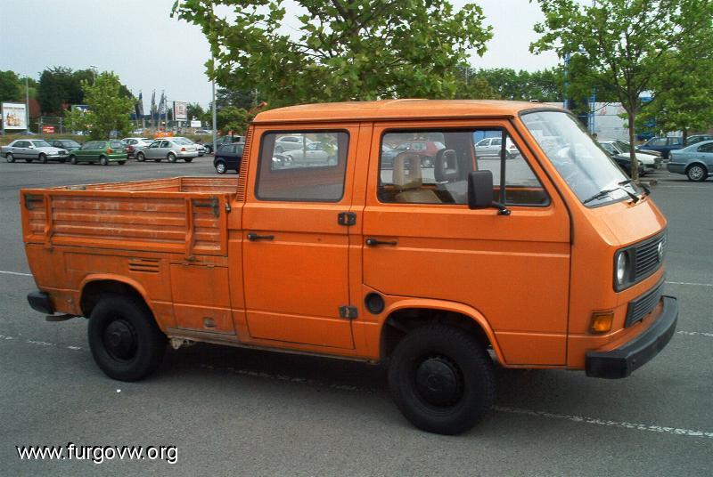

Cita de: MallorcaJoe en Noviembre 20, 2009, 06:59:56 am

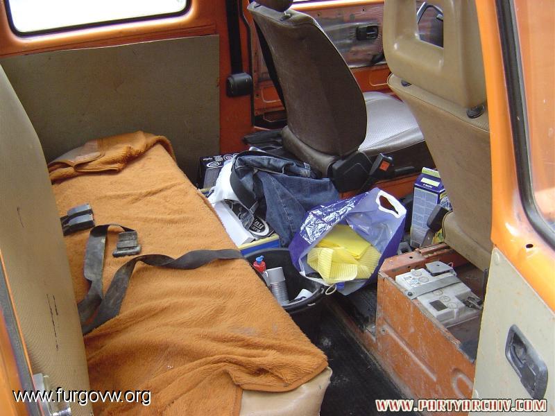

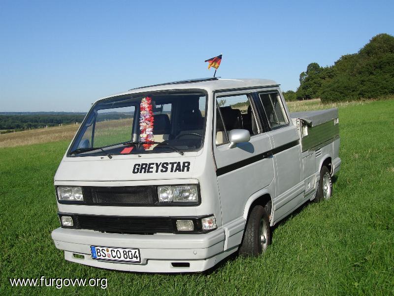

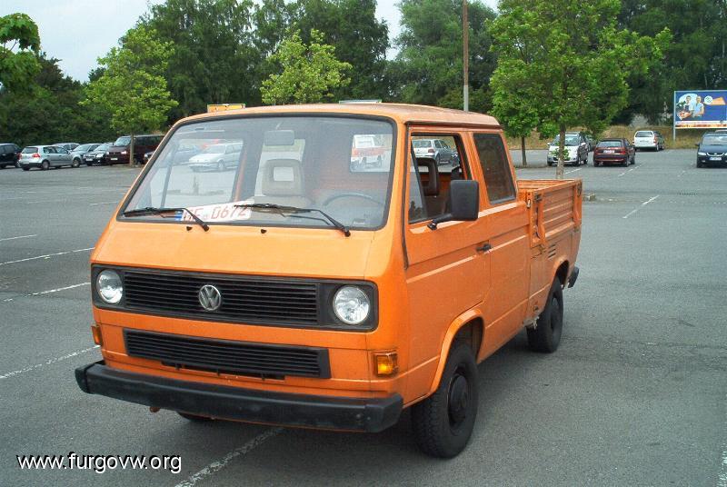

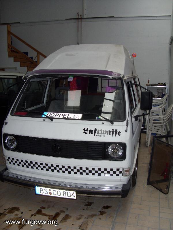

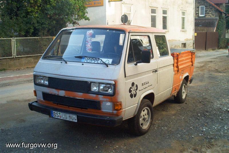

Hello from Germany. Sorry for writing in English.
I accidentally found this page and was very astonished  to see my old DOKA here. I bougt this car in 2005. At this time it was orange. Well, the DOKA seems to be in good hands, so I may show you some of the photos of its time in Germany.
Best wishes and have and always a nice trip.
how I bought it in 2005
2006
Soccer World Cup 2006
Inside
2007
And what I drive today
For the plate it is from Braunschweig , Germany , I was living there  ;D
