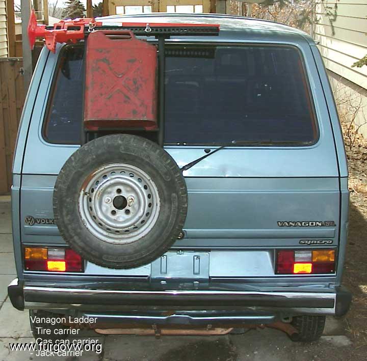

ooznak
http://www.telusplanet.net/public/gary2a/rack/ladder.htm
Vanagon rear hatch ladder
Carrier for gas can, spare tire and Jack
Attaches to rear door with special clamps.  Door can be opened and closed while the ladder is attached.  Does not interfere with
the rear wiper. No drilling or holes needed.   All threaded parts and fasteners are stainless steel. Can be mounted on either side or the
center of the door.
Ladder is $299.00 US dollars (black powder coat).  Shipping $45 - $65.
Gas can carrier $99 extra
Lock for gas can carrier $10
Tire carrier $85 extra
Tire lock - lock your tire to the rack $20 extra
Hi-Lift jack carrier $69 extra.
Ladder Lock - lock the rack to the van $30 extra
All prices in US dollars.
How to keep the rear hatch open with a ladder mounted
This ladder can be made in various configurations: 2 gas cans, 2 tires, tire on the bottom or top.  Can be used as a ladder when tire and gas can are removed.
Weights: A 5 gallon gas can and weighs about 45 lbs full.  The stock 14 inch steel wheel and tire weigh 45 lbs.  The South African 15" alloy wheel with

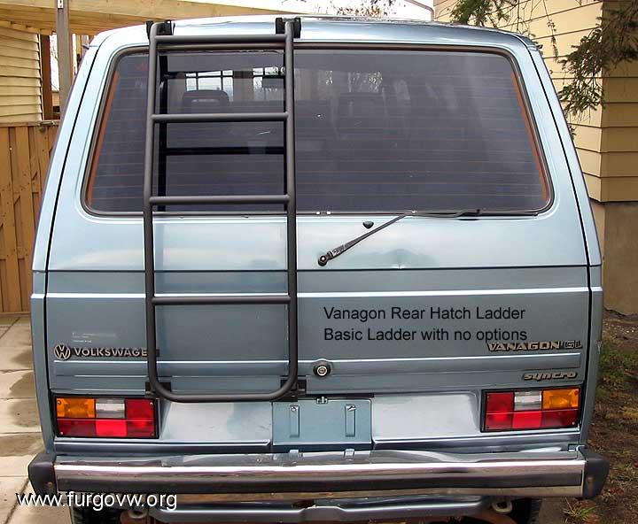

Enero 05, 2008, 11:25:04 am #88 Ultima modificación: Enero 05, 2008, 12:38:44 pm por Amedio
A mí también me interesa, pero me parece que el precio que te dan de 210€, teniendo en centa como anda el dolar unos 300$, es de una escalera simple como esta:
Creo que habría que sumarle "Tire carrier $85 extra", unos 60€ más, si queremos tornilos portaruedas. Lo que me gusta del aparato es que parece fácil de quitar y poner. Yo me apunto, ya estamos 2 en galicia y 1 maño.
