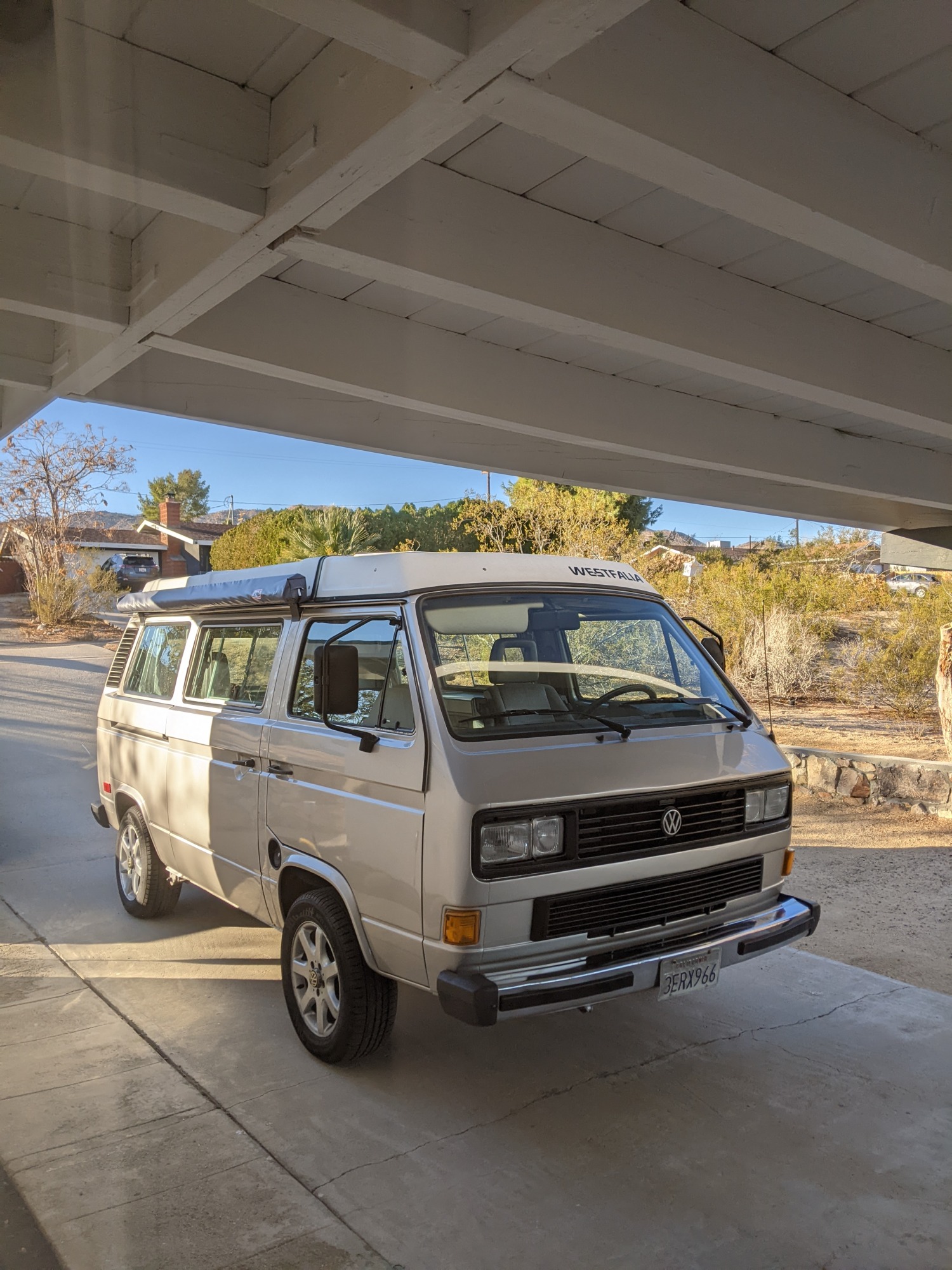

P.S. Here is a picture of Heidegger, our beloved van :)
jabo
No me extraña que no quieras deshacerte de ella, esta impecable!, felicidades!

Cita de: Banja en Junio 09, 2022, 12:41:12 pmP.S. Here is a picture of Heidegger, our beloved van :)
Damn.. Awesome van. Hope you join the local meetings near Barcelona so we can see her.
