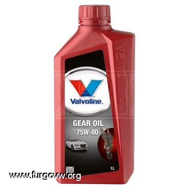

Yo ya tenia como posible compra el Valvoline MaxLife MTF GL4 75W80 y despues de leer esto ya lo tengo decidido.
http://www.mercedesmedic.com/diy-transmission-oil-change-722-6/
DIY Automatic Transmission Fluid Change 722.6 5-Speed
You should consider changing the automatic transmission fluid and filter on your Mercedes-Benz every 60,000 to 80,000 miles. Years ago Mercedes-Benz claimed that these transmissions were sealed for life and didn't require any oil change. But their recommendation on transmission fluid has changed and now they recommend that you do change the fluid.
Many owners and mechanics believe that if you change the transmission fluid you may experience transmission problems. The argument that is used to support that claim is that the transmission will act up because the viscosity of the old oil has changed compared to the new. Or that there may be particles that will be dislodged inside the transmission which can clog the new filter.
Our recommendation is to change the transmission fluid to extend the life of the transmission.
Required Transmission Oil
You will need 10 quarts of transmission fluid. Mercedes-Benz recommends that you use the MBZ ATF 236.14 transmission fluid. The only problem is that that oil sells for around $20 per liter.
Transmission Fluid
Valvoline MaxLife Transmission Fluid Alternative for Mercedes BenzIf you are looking for an alternative to Mercedes-Benz oil, we would recommend the Valvoline MaxLife or the Shell 134 transmission fluid. It is important to understand that Mercedes-Benz doesn't have these two fluids on their approval list. That doesn't mean that these fluids don't meet the required specification. In fact, the same 722.6 transmission is used in many Dodge cars, and Dodge does use the Valvoline MaxLife in the same transmission. We have also used the Valvoline MaxLife in multiple Mercedes-Benz cars and have not experienced any problems. Valvoline Maxlife says that their oil is suitable for Mercedes-Benz, and Shell states that it meets the MB specs.

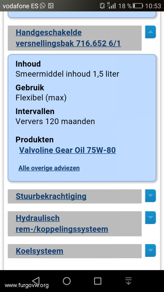

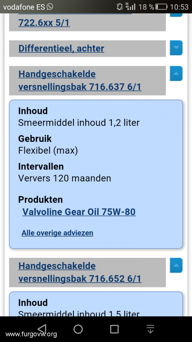

También lo recomiendan.
Segun Valvoline es el aceite que recomiendan para las cajas manuales 716.637 (1,2 litros) y para la 716.652 (1,5 litros)
http://valvoline-eu.lubricantadvisor.com/advice.aspx?lang=nel&type=23eb1da72316afbae06085e34b3d6c0a

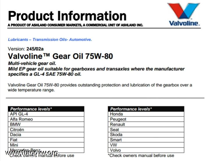

Pantallazo y link a la hoja tecnica.
Pone Mercedes Benz no?
http://www.valvolineeurope.com/uploadedFiles/6918.pdf

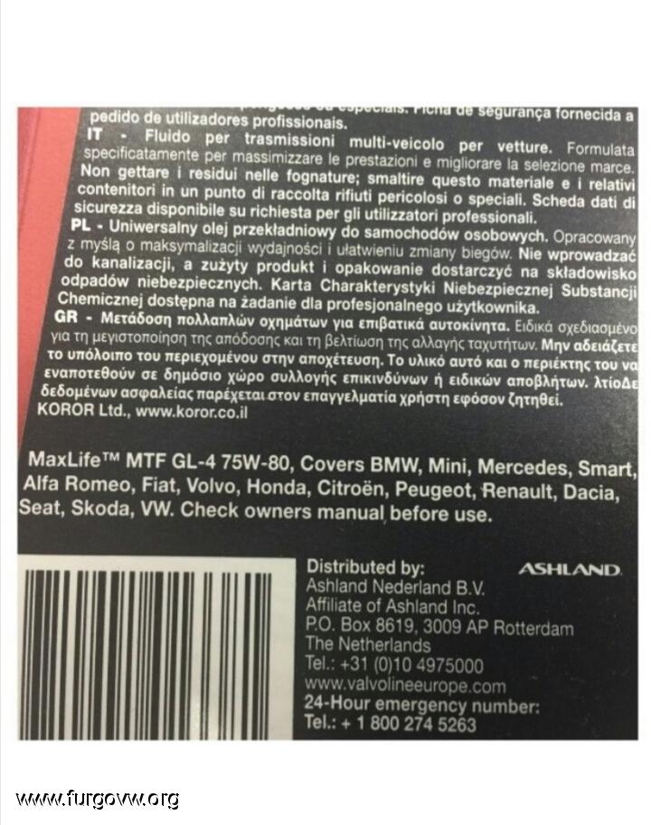

Y para los mas escépticos imagen de la etiqueta trasera.

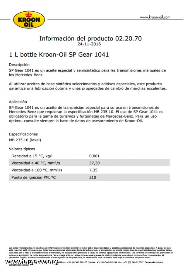

Hale, mas para elegir.
No es aceite de multinacional pero vamos, para que digan esto en la hoja tecnica tela...
En esta web alemana lo podeis comprar por paypal por 32 euros los 2 litros + el envio que no se cuanto sera.
https://estore-sslserver.eu/belo-shop.de/epages/0a88d554-8341-416c-b3d2-c6dd0a60e0cf.sf/de_DE/?ObjectPath=/Shops/0a88d554-8341-416c-b3d2-c6dd0a60e0cf/Products/01637
