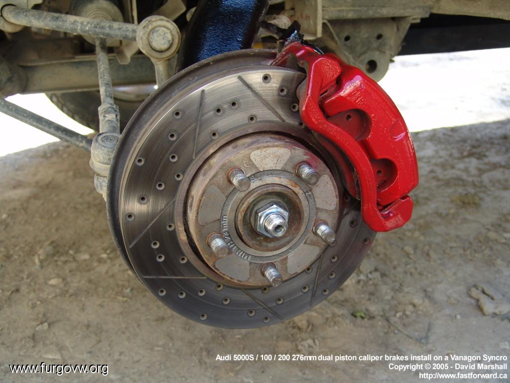

A ver que os parece... desde mi ignorancia ... no parece muy complicado no?
http://www.syncro.ca/tech/audibrakes.htm
Materials needed:
QTY   Part #   Description
2   477 615 301 B   Audi 5000S / 100 / 200 276x25mm vented brake rotors
2   477 698 151 F   Audi 5000S / 100 / 200 brake pads
2   447 615 125   Audi 5000S / 100 / 200 caliper carrier assembly
1   447 615 123   Audi 5000S / 100 / 200 dual piston brake caliper
1   447 615 124   Audi 5000S / 100 / 200 dual piston brake caliper
4   M16 x 80   10.9 strength bolt
4   M16 washer   flat washer
4   M16 nylock   nut with nylon lock or use blue loc tight
4   M16 8mm spacers   8mm spacers for between the hub assembly and caliper carrier
